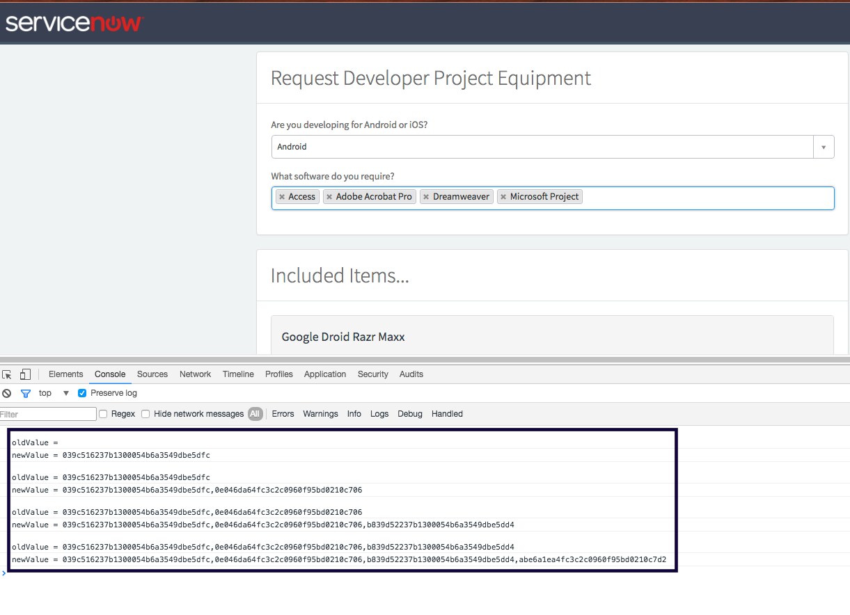

Hi Reva,
I believe you can use the oldValue and newValue of the Catalog Client Script. They seem to work fine in the Service Portal for the List Collector variables, I just made a test in order to print value of those variables in an onChange Catalog Client Script (which variable is a List Collector).
See the script:
And the results in the browser console:
So I believe you can get rid of rightBucket and then just check if the newValue contains your other value (by using the indexOf JavaScript method for String).
Note: g_form.setMandatory should work absolutely fine in the Service Portal, so whatever is the issue with your script it should not be rooted in that function.
Loris
