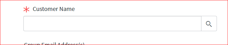

Hi all
I'm developing an scope app and I have come across a scenario where I must access a field value( Question) defined on the Catalog item say "Customer" from a client script of  Multirow variable set  and filter only the visitors belongs to that Customer.
Customer field on Catalog variables section
Based on the customers the visitor (reference field) of the Multirow variable set needs to be filtered and displayed.
Kindly share your advice how should I get the value of Customer field on to the client script of Variable set.
