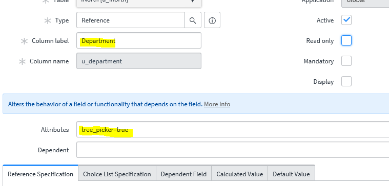

Hi Harsh,
Thanks for your input.
I tried with the tree picker but it isn't working and shows the normal LIST layout(when the lookup icon was selected), does the tree picker attribute doesn't work on a custom field
please check the dictionary overrides of this field . i think there tree_picker=false has set.
