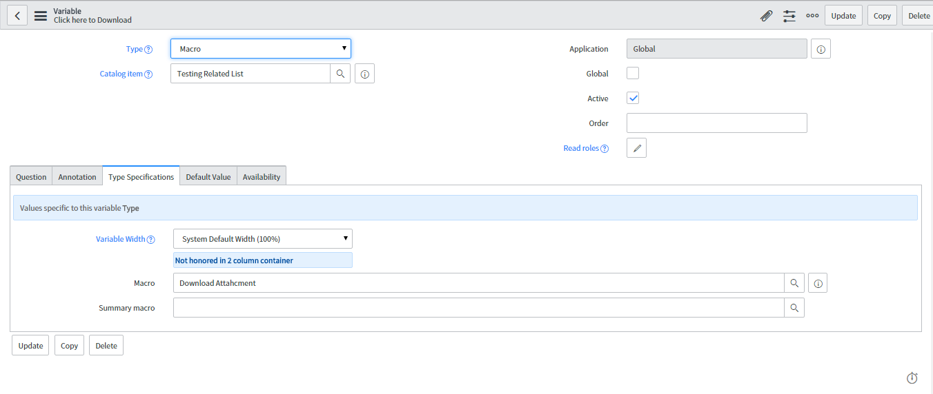

This can be done as per the steps mentioned below:

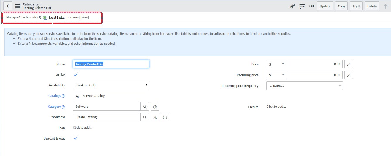

1) First of All Upload the Attachment file which should get downloaded on click of the Variable to the Catalog item which contains that Variable.
2) Create a UI macro as per the below script:
Script:
<p><a href="/sys_attachment.do?sys_id=ca72962870e8960020d27bce9ea54623" title="Click Here to Download the Attachment">Click Here to Download the Attachment</a></p>
</j:jelly>
Navigate to sys_attachment Table and copy the Sys_id for the latest file uploaded as per Step 1 and replace the same in the UI macro script shared above.
3) Once the Macro has been created, create a Variable with Type as "Macro" and attach the macro created above in the Type Specification tab of the Variable.
Have tested this on my Personal instance and it worked. Kindly test the same from your end also.
Hope this helps.Mark the answer as correct/helpful based on impact.
Shloke
