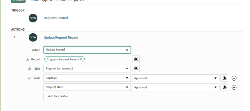

I want to automate the RITM after it is created from service catalog. Now after ordering from service catalog, REQ and RITM gets created. Now i want to automate and auto approve the RITM and move the state to Work in Progress. How can I do that using flow?

hi @SamiranD ,
Go to flow designer and create a new flow with run as system user
Use trigger -> Service catalog
select your catalog and use update record action to set the states,

Hi @SamiranD ,
Create a flow with your approval and fulfullment logic inside it . Attach that flow with your catalog item.
When you will order an item, flow will trigger for approval. Once request is approved , it will move to fulfillment.
