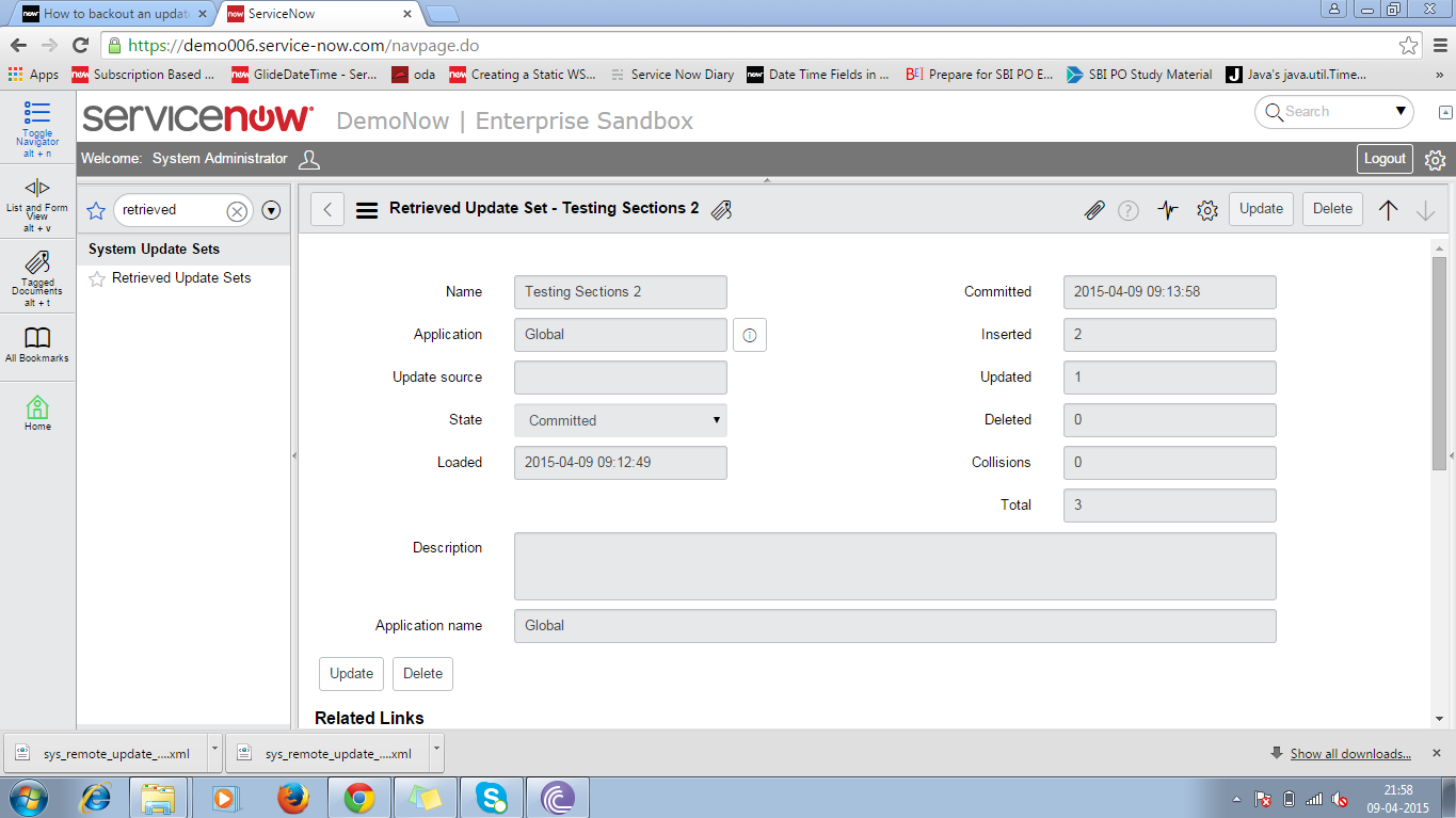

Sorry to bother u again anurag,
See on demo006 this is the last update set committed, here i am unable to see the backout button
But if you go to demo005 from there i am able to see back-out.Do you know why this is so.
Gaurav
