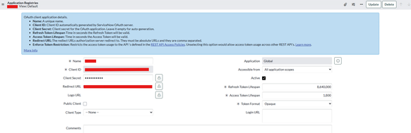

Below is the configuration we have from ServiceNow

Can you share more of your setup? Are you sure you are not using authorization code flow for your oauth which does require user interaction as the tokens are issued with delegated permissions, this would take you to okta to authenticate? Assuming okta is your auth app as well. What you might want is to use the client credentials flow.
I've added the configurations used from our end and the URL used by the third-party
