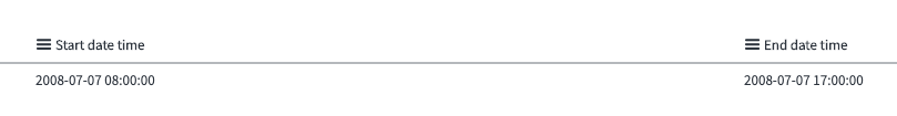

Ok. I think what you need to do is query the schedule entry and pull the start and end date from there as well to get the number of hours per day.
For ex, below is a schedule entry where start and end date difference is 9 hours. you can get the difference and then divide it from the dur you got above to get the number of days
