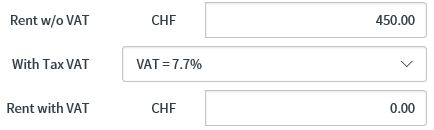

03-14-2019 02:37 AM
03-14-2019 02:56 AM
The value of the choice should be changed from "VAT = 7.7%" to 7.7
Only the value. The label can be the same as now.
Remember that you calculate. You cannot calculate a value that is "VAT = 7.7%"
You also need to make sure that the other fields are correct. "u_rent" and "u_rent_with_vat"
Its the name of the fields you have created

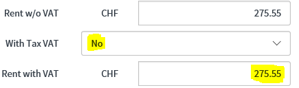

03-14-2019 09:43 PM
Thanks so much, Simon for your supporting
Small issue in our code.
1. Vat = 7.7% .(dot)
Rent = 250.00
Rent with VAT = 250 * 7.7% = 269.25
Currently, I'm getting like in the below way
In the below way we want
2. Vat = No
Rent =255.75
Rent With VAT = 255.75
