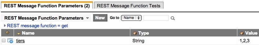

Interstingly enough, I do think this is a little confusing for people new to using the RESTMessage functionality. There are a couple of things that you need to do. First, create a new REST Message Function Parameter Definition. Give it a name (like Tiers) as well as a value that is a macro (like ${tiers} (see attached screenshot).
Once that is done, go to the bottom of the form and create a new REST Message Function Parameter. Here you should define a name (Tiers), type (String), and value (1,2,3). The value here is used when you do a test and is not to be considered a default value when you're using it via script (see attached screenshot).
Finally, you may now invoke this RESTMessage by using script like the following
var r = new RESTMessage('Forum Demo', 'get');
r.setStringParameter('tiers', '1,2,3');
var response = r.execute();
Hope this helps!
