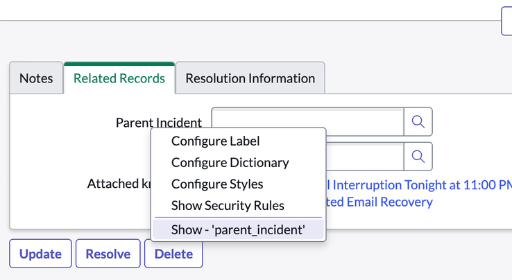

You can use the SN Utils for a quick solution. Otherwise, right-click in the field, click "show - field name," and you’ll be able to see the backend name
As per your solution it's correct for remaintion fields but for sections like resolution information we want back end name when we do your process its wont work relates to incident form
