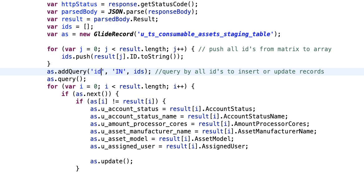

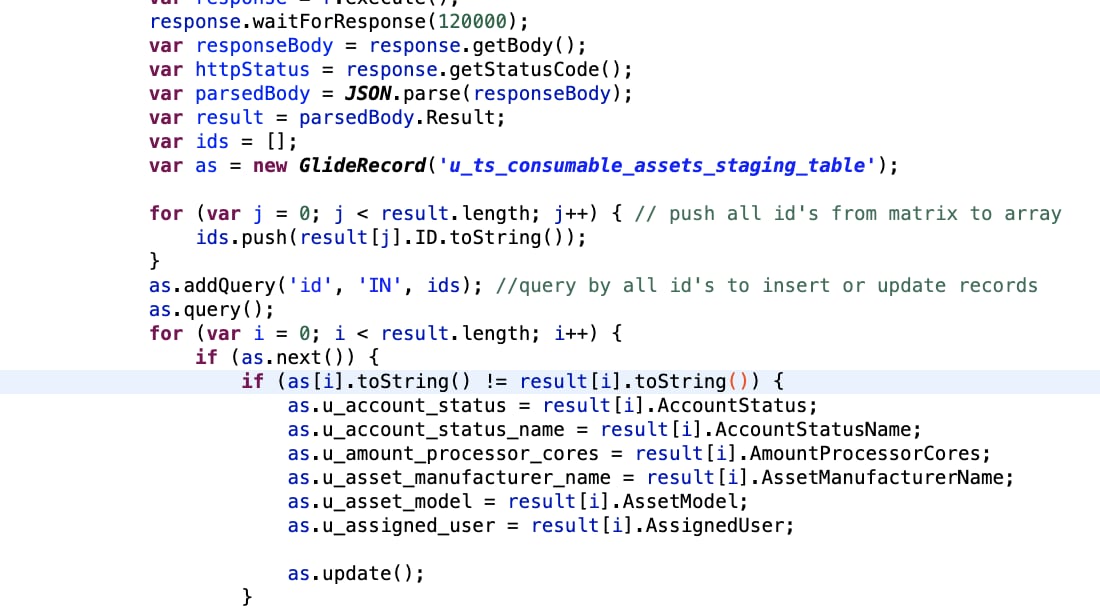

Hi guys, is it possible to check if one of the fields was updated in Script Include ? im populate fields with script include rest api data, and i need to check if fields the same - do not update it

Since you have multiple record sys_ids you need to iterate over each record and check
Also if you want to check for multiple fields then you need to check them one by one and if not same then update
sample script below:
as.addQuery('id', 'IN', ids);
as.query();
while(as.next()){
for(var i=0;i<result.length;i++){
if(as.u_account_status != result[i].AccountStatus)
as.u_account_status = result[i].AccountStatus;
if(as.u_account_status_name != result[i].AccountStatusName)
as.u_account_status_name = result[i].AccountStatusName;
as.update();

please explain with some example
