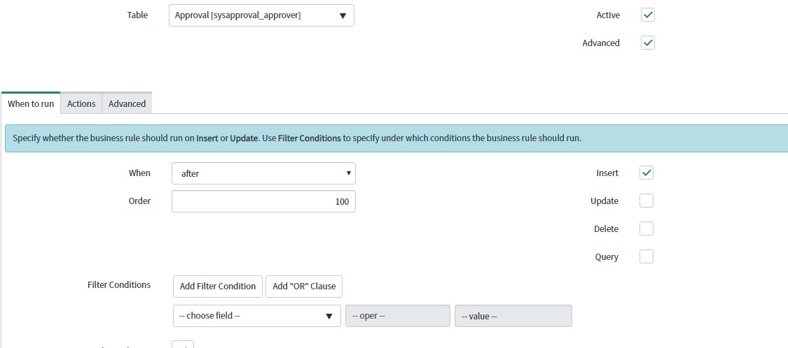

I created a business rule to allow approvers to see the attachments added to the application in the portal.(Global)
Weirdly, however, we realized that we needed to enforce this business rule before an authorization record would occur.
System log:
My boss told me to use 'gs.sleep' as a way to make this delay.(Global)
Refer to:
However, it doesn't work well.
Can you point out what is wrong?

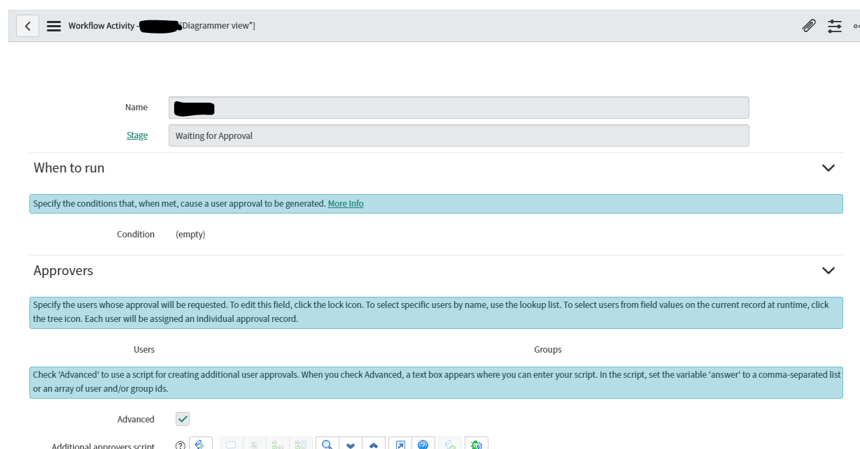

Okay, I see.
This caused the business rules that were running when the timer was set to stop working..
I'd like to implement this delay like the timer in the capture above, but can I tell me where the delay is different or where I can point out?
BR is ...(Do I need to change after this settings?)

04-13-2020 12:32 AM
sorry. I'm not sure why the delay is needed, but I've found that setting a timer before the approval record fires works.
Yes, I just want to push the attachment from RITM to the approval record and allow the approver user to view the attachment, so if this is possible I don't need to defer it.
