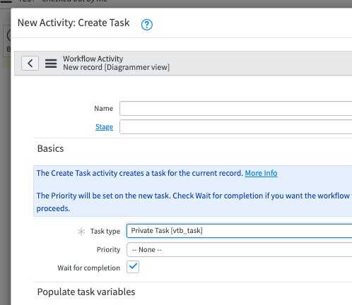

Hello
Yes, you can.
You can use the "Create Task" activity and select the "Private task" table in a workflow associated to and SR in the Service Catalog.

Thanks for replying but this will also create a request right? I only want a private task to be created.
