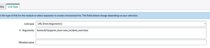

I've a question about Module of Application menu.
We created a dashboard with pa_dashboards, And then we wanna display dashboard in Module of Applciatione menu.
But, It's not going well.
How should I set it?
The dashboard URL is "https://xxx.xxxx-xxx.com/$pa_dashboard.do?sysparm_dashboard=880f5328db9b21107c16f9a1f3961946&sysparm..."
Kentaro.
5 REPLIES 5
Jim Coyne
What is "not going well"?  What are the current results?
The URL should be:
$pa_dashboard.do?sysparm_dashboard=880f5328db9b21107c16f9a1f3961946&sysparm_cancelable=true&sysparm_editable=false&sysparm_active_panel=true&sysparm_ignore_default_filter=false;
That should work, assuming "880f5328db9b21107c16f9a1f3961946" is the sys_id of the Dashboard record.

@Kentaro Numata  , I see your updating Incorrect Argument , Please update the Following link into your Argument ,
$pa_dashboard.do?sysparm_dashboard=880f5328db9b21107c16f9a1f3961946&sysparm_tab=521f1368db9b21107c16f9a1f396194b&sysparm_cancelable=true&sysparm_editable=undefined&sysparm_active_panel=false&_ga=2.242545409.2090726348.1707117402-1095250165.1705494237

Hello @Kentaro Numata  ,
have used your URL and Formatted the Same , you should always use the second parameter that is after Instance Name
