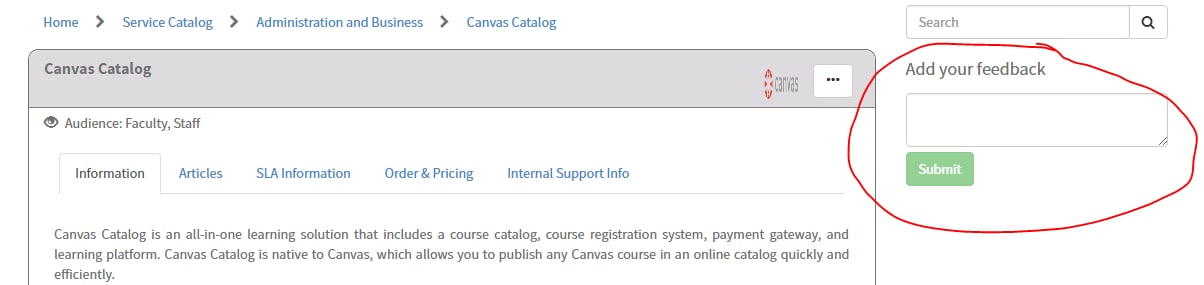

I used the same logic where I created a table to hold the feed back with CI (reference), user, date/time comment and rating score. then for the user interaction I wrote a widget.
I went with CI since we relate all forms to a CI and upper management wanted feedback per CI. If you want you can add a catalog item reference field to track both or just use one reference field.
I have attache my update set for CI feedback. In the widget in the update set you will need to um-comment the rating html code. upper management just wanted comments

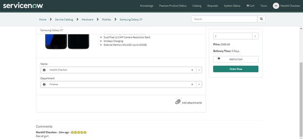

Following are the steps that I followed in order to display and implement the comment/rating functionality of kb articles on catalog item :
Step 1 : Created the custom fields in table "sc_cat_item" as attached in the screenshot.
Step 2 : Cloned the widget "KB Article Comments" and used it in page Service Catalog. Edited the text to "Rate this Catalog Item" in HTML part of widget.
Step 3 : Change the gliderecord table to sc_cat_item in Server Script
Note: You can create a custom table to maintain the feedback for catalog items.
Step 4 : Test the functionality with any catalog item by submitting the ratings and comments.
Step 5 : Check for the feedback record in kb_feedback table
