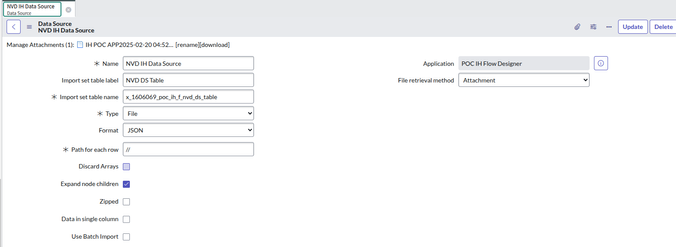

I found the solution—by keeping the JSON data the same and providing the correct path for each row (in my case, //), the issue was resolved. Additionally, I had to click Expand Child Node for it to work correctly.

The screenshot below might help you.
If we create our data source in the above way, there is no need to use object.
