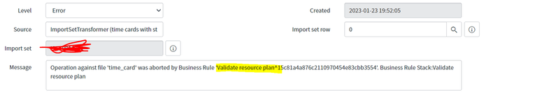

When I am trying to import the time cards , I am facing the following issues:

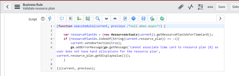

  1. For Project time cards, The Business Rule: ‘Validate resource plan’ is not allowing me to insert the time cards though I am associating right Resource plans. For the same user when I go and check in Time Sheet Portal UI, it is showing the same Resource Plan which I am trying to add through import set.
Attaching the Business Rule code snippet ,

I want to be able to update the time card fields with correct values with import set. I do not want to disable the BR: Validate resource plan, as I want the system to flag the error for the record where user is putting Resource plan that is still not allocated for them. If I disable this BR then if user specify wrong Resource Plan, system would still insert into the table.

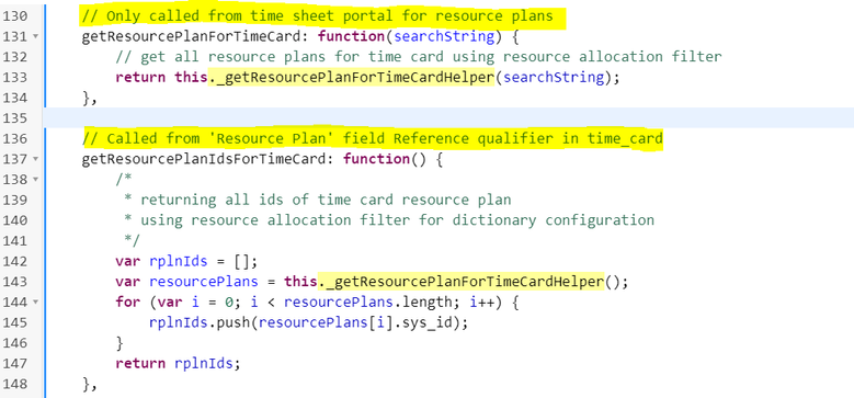

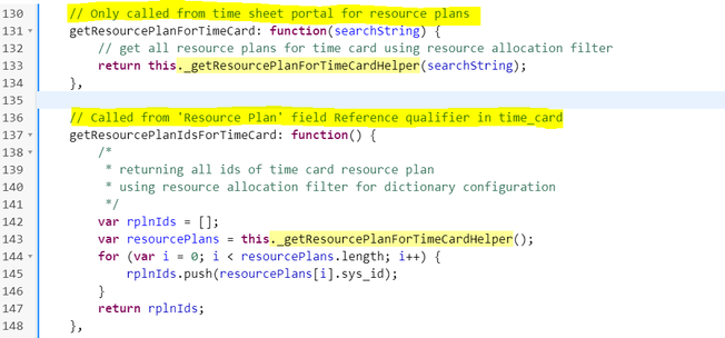

I feel OOTB _getResourcePlanForTimeCardHelper  method has some bug since it is not getting the right Resource plan that is allocated for user.
When I try from Time Sheet portal for the same user, the same Resource plan is displayed and allowing the user to submit the time card.
The functions used to get the Resource Plan ID are different for Time Sheet portal and when I insert from import set, as I have high-lighted in screenshot.
When I check the Reference qualifier of Resource Plan field in Time card form:
I want to understand whether Reference qualifier needs some changes or _getResourcePlanForTimeCardHelper() function.
