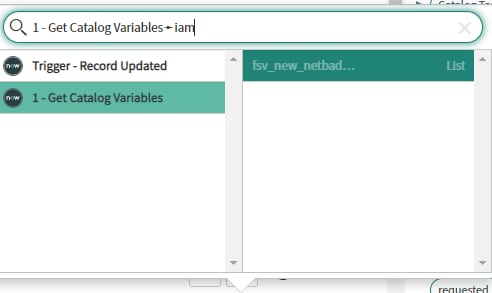

I have a flow that needs to set the list collector values to a list field in another table , When I use the dotwalk directly I cannot see the field populated in the flow, If I use the script it is throwing an error below.
both the variable and field points to same table
Variable : find_real_file.png
Field:
Flow : The variable is not selectable
I used the below script :
return fd_data.trigger.current.fsv_new_netbadge_iam_roles; below is the erro

You can directly fetch that updated record and then use the create record flow action .
eg:
1. Triger action
2. getVariables
3. Create record : here you will set the field value eg:
var ds= fd_data.trigger.current.variables.<variable Name>;
return ds;

You need to use a For each in FLOW on a list collector. For each value, do this.
Thanks For that , I added the for each item and from there added the update the newly created record , can you please help me with the logic what I need there to update the record ?
In the field IAM Roles, where it says Select a choice, use the data pill and choose your for each record.
