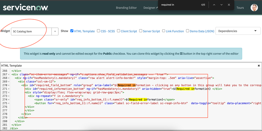

I'm looking to see if there is a way to hide the "Required information" boxes shown at the side of a catalog item in the portal. See attached.

Turns out there is an OOB option for turning this off! Navigate to the page with the widget you'd like to turn it off for and CTL + Right Click on the widget. Deselect "Show Field Validation Messages." See the screenshots below with "Instance Options."

This widget appears when there are variables that are mandatory on the catalog item, and then this widget will show up.
I'm aware that it appears when variables are mandatory. What I need to do is simultaneously keep the variables mandatory but remove the boxes on the side.
Hi @Daniel Arnold That’s not the recommended approach, but if you still want to proceed, I’ve shared the widget earlier.
Open that widget and either remove or comment out the "required" tag, as mentioned in the previous post.
