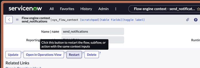

If this is just a one off, then you can restart the flow from the sys_flow_context record:
