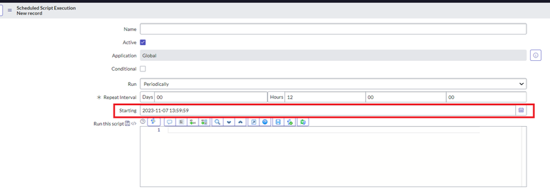

@nirwan_ritik You need to configure scheduled job periodically to run twice a day as per above screenshot. If you want to second scheduled job to run after one hour from first job then you need to select starting date for 2nd scheduled job after starting date of 1st schedule job. Difference should be 1 hour

Depends on what you mean by twice a day but here is one way to do it.
Setup the scheduled job to run periodically every 12 hours.

Hi Niklas,
Thanks for the quick reply. The use case is I have two scheduled jobs. Job1 and Job2. Both of them should run twice a day & Job2 should run after an hour for Job1 execution.
Thanks.
SANDEEP28
@nirwan_ritik You need run scheduled job periodically for every 12 hours to run twice a day
