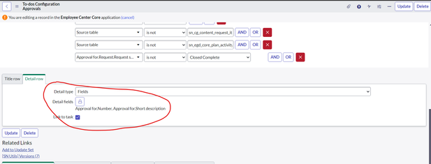

Hello @snow34 ,

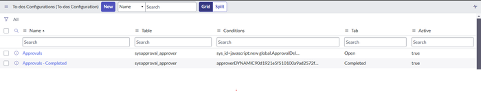

Search "To-dos Configurations" in your navigation and Open the approval table records.
There are two records for the "Open" tab and the "Closed" tab. Do the same for both.
Open the records and add in the detail row tab>details field
