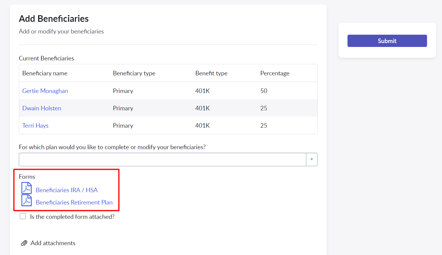

Hi Denis
There is a OOTB way to do it, but only on HR module. On the HR module exists a form with this type of link.
Basically this list of attchments is a variable on the record producer with a widget embedded
I recommend you to install the HR module and clone that widget and adapt for your requirement.
If you need further help just tell me. I think this is very easy, but tricky to accomplish
