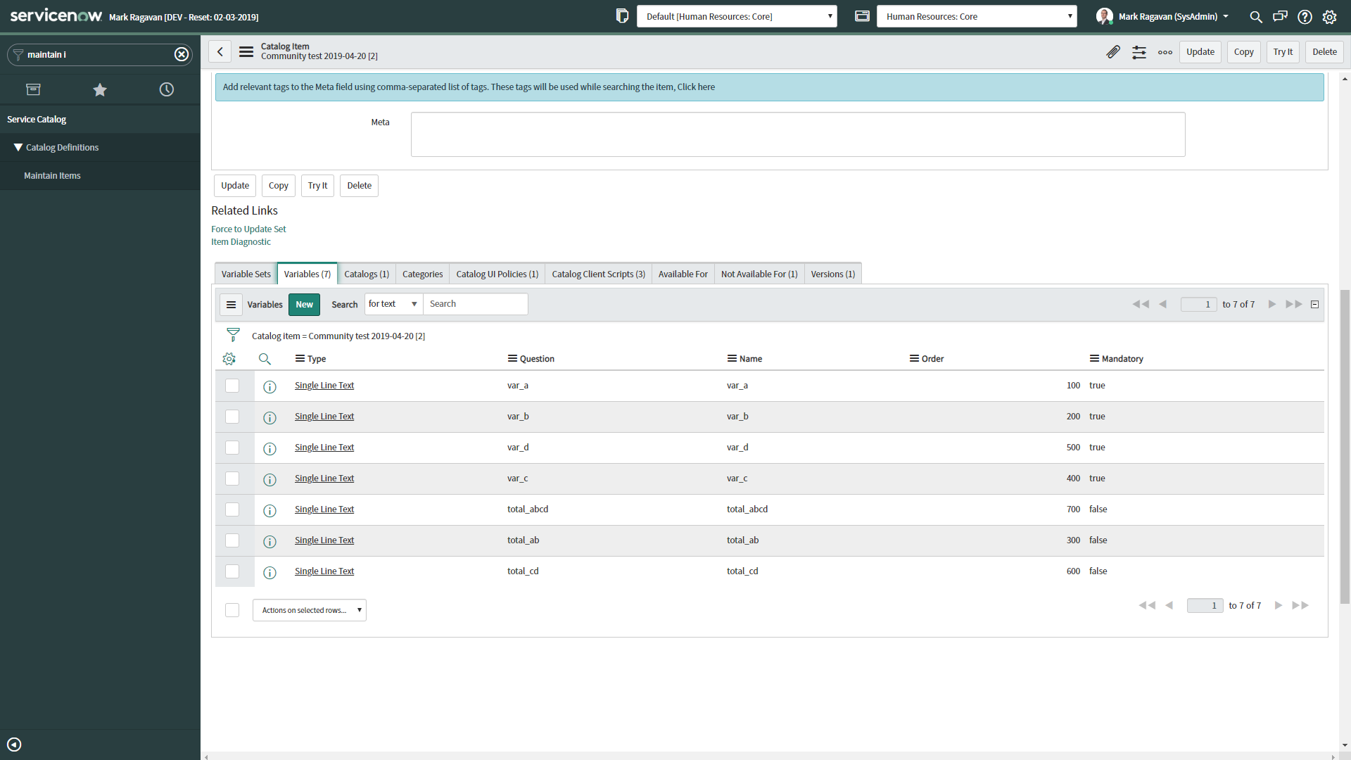

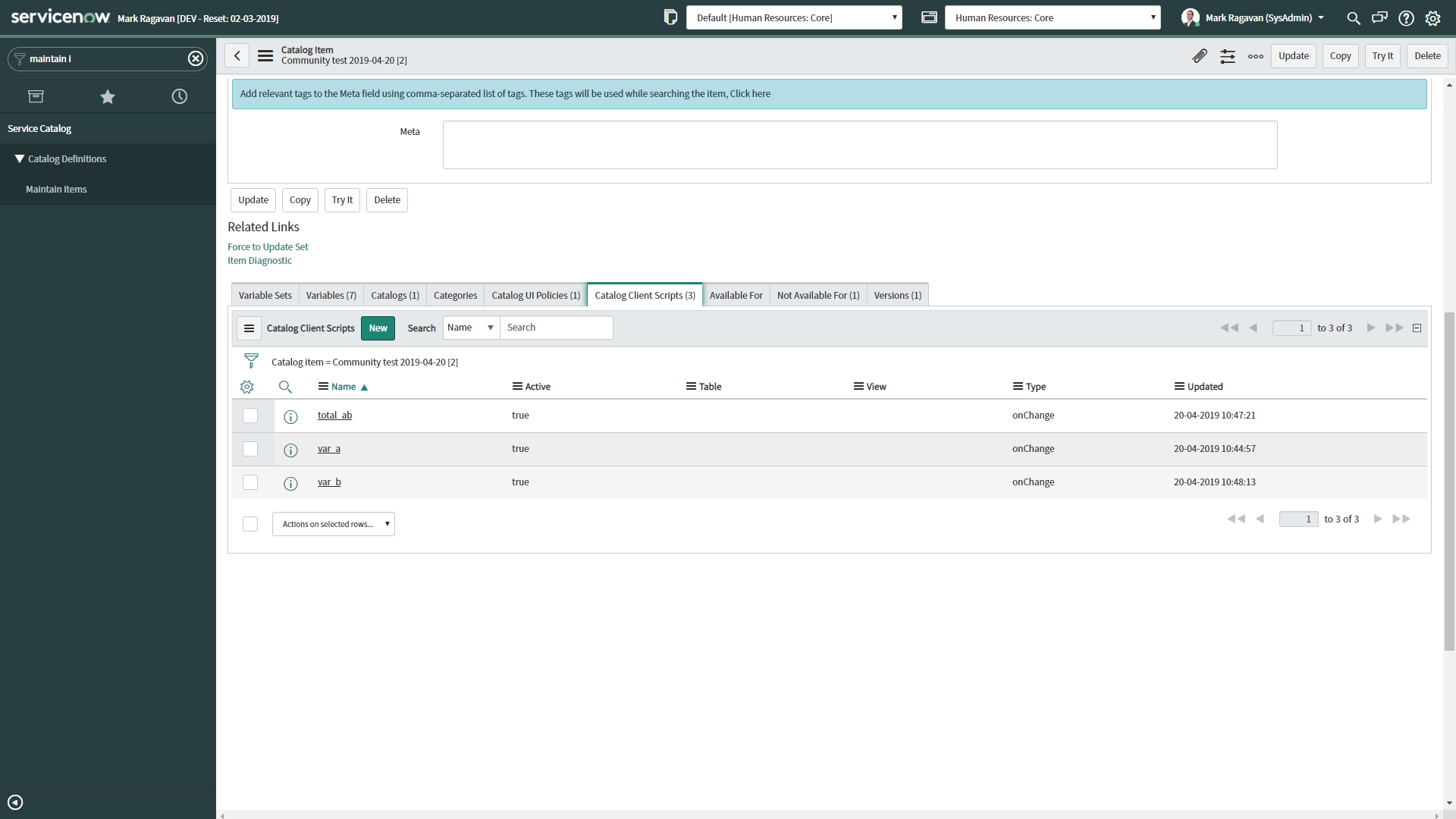

I just did a small test. See the results below. I did only do the var_a, var_b, total_ab, though you'll get the logic of it. Maybe it could be done a bit more efficient with variable names, variable reusing, etc..
In my test I tried to simplify the situation, I saw your script was massive! If calculating var_a + var_b, no need to calculate other stuff at that point. Just do that in another short catalog client script where you know the input is clean, avoided the NaN, etc..
Though just a quick working test!
Obviously, you could have slightly different requirements. What if the user forgets to enter the dollar sign, is that bad? Could you onChange at the dollar sign instead of giving an error? What to do if someone empties the value, by default there's a check newValue == '' after which the Catalog Client Script returns, maybe change this into setting the default value of $0.00 in that case.
Etc..
