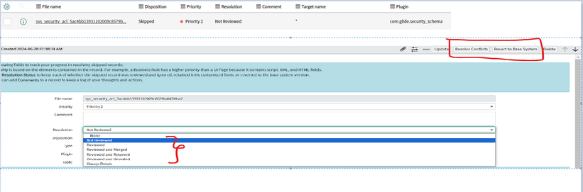

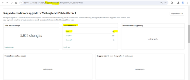

Modifying an OOB UI action condition will likely create a skipped record during the next ServiceNow upgrade.
Skipped records are created when an upgrade detects customizations in OOB records, requiring manual review and resolution.
--> After an upgrade, you can choose to keep your customization, accept the new OOB version, or manually merge changes.
PFB image of skipped log and how you can act on it :-
