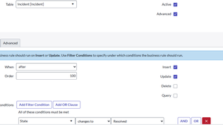

VijayshankaK
    // Add your code here
    var probGr = new GlideRecord('problem');
    probGr.addQuery('first_reported_by_task', current.sys_id);
    probGr.query();
    if (probGr.next()) {
        probGr.work_notes = current.close_notes;
        probGr.update();
})(current, previous);
Above BR not working
