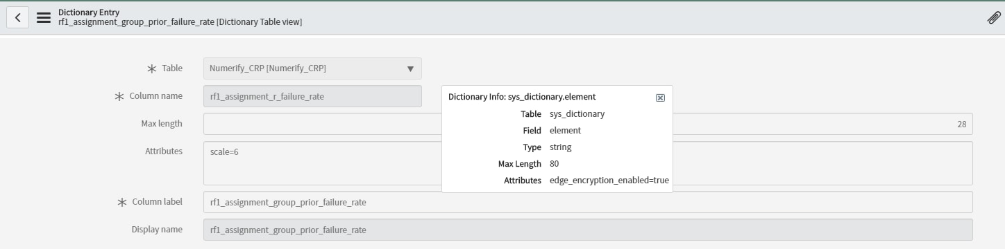

Can you help me with code , to increase Table->Column Name size to 50 chars from Glide script. Default column name allowed seems to be 30 chars.  I have column name as 'rf1_assignment_group_prior_failure_rate' , when creating from script it truncates to 30 chars as 'rf1_asgmnt_grp_r_failure_rate'.

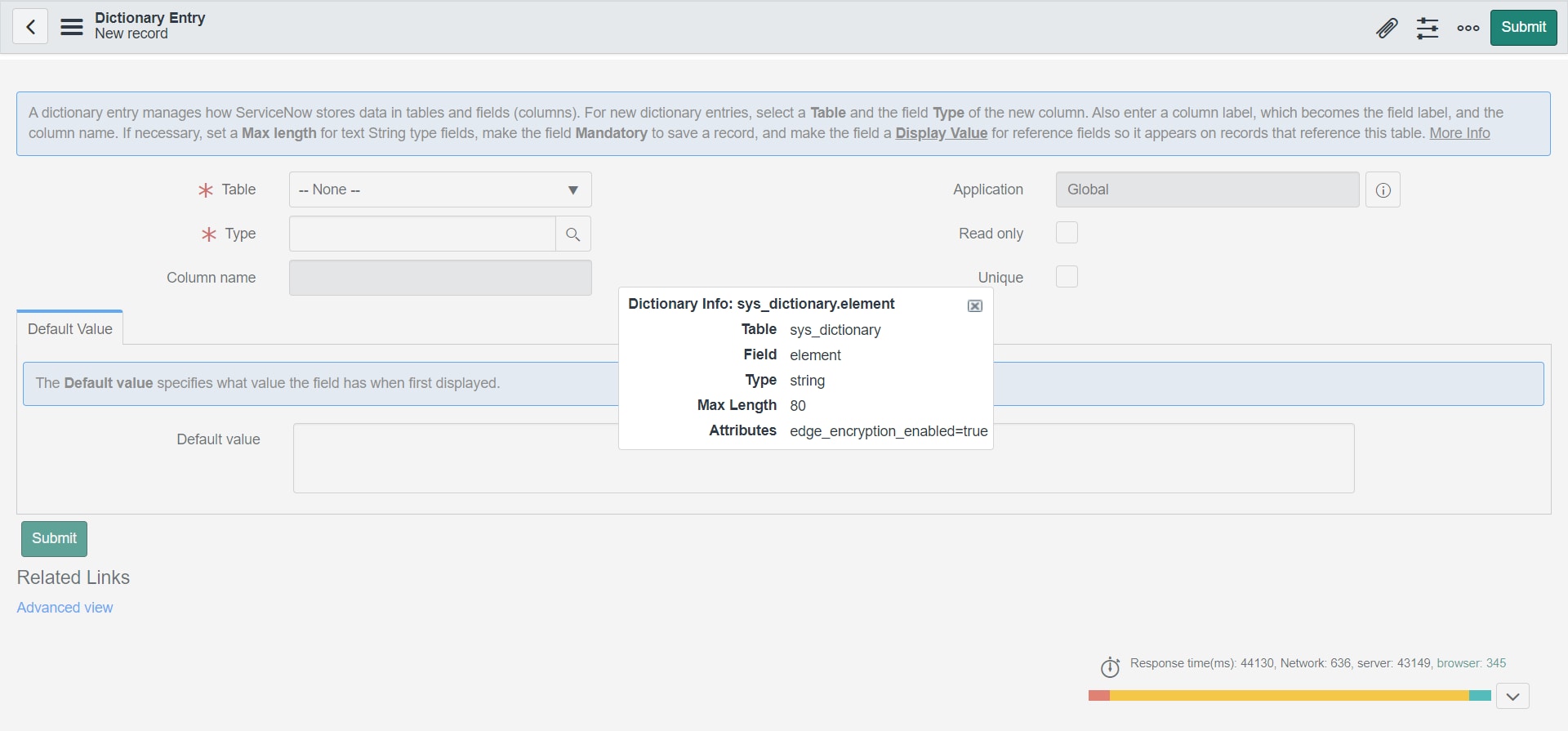

if you are referring to the below screenshot then it has 80 as max length;
Are you referring same or something else? Also share screenshot?

Thanks for your response. I am running a script to create the column name. but, it truncates to 30 characters.
for e.g , from above script ,  column name is created as shown in screenshot. (it's truncated to 30 characters)

but in my case the column name has length as 80; what's the max length for it in your instance?

Below is the screenshot for my column name. It seems max length is 80, and manually I can create column name with 80 characters. But, using script it truncates to 30 characters. [ display name is created with 40 characters from the script ]
