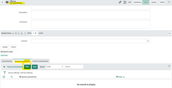

We have service commitments (service_offering_commitment) attached to service offering(service_offering)  as a related list and currently only admins have the ability to remove commitments.
We have added a delete ACL so that certain users having a particular role can remove the service commitments from service offering. And they can delete/remove using edit button in the related list of service offering. This is done but whenever a commitment record is removed, we would like to show an info message on service offering form. How to achieve this? Please help
