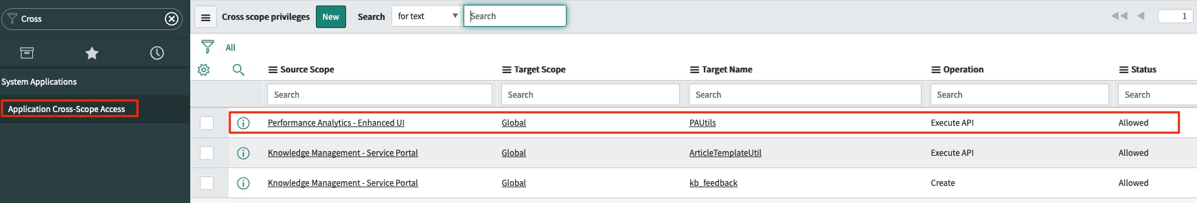

You need to allow data operations from other scopes. There are few things that you schould check when you problem with Application to Application access, so issue with scope.
1. How your table configuration look like? Do you allow access from other scopes and what type of access do you allow. Check the Application Access tab on your table configuration.
2. Go to System Applications > Application Cross-Scope Access and check if you have entries that points from your scope to gloabl scope with Target Name being your scoped table. Example below:

10-15-2019 05:08 AM
Tried this but no luck. Actually cannot create cross scope from global to scoped application
