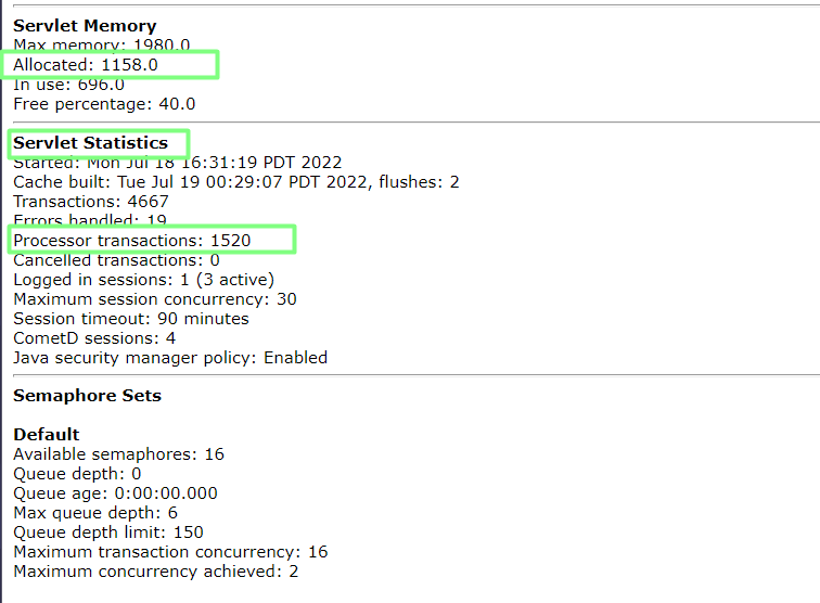

By the way, this line of code
var memUse = diagNode.stats['system.memory.in.use'];
were able to get the memory in use, how were you able to come up with the system.memory.use, do you have any reference for looking through stats.do. Because for example we want to also display the allocated memory, how do we write it.
Or we want to get the other processor transaction values how do we modify the script for that.

Are these the one referenced in the script?
But when I looked for the content of it I can't seem to find how he was able to come up for which code to use to point for memory in use and what I can use for memory allocation.
