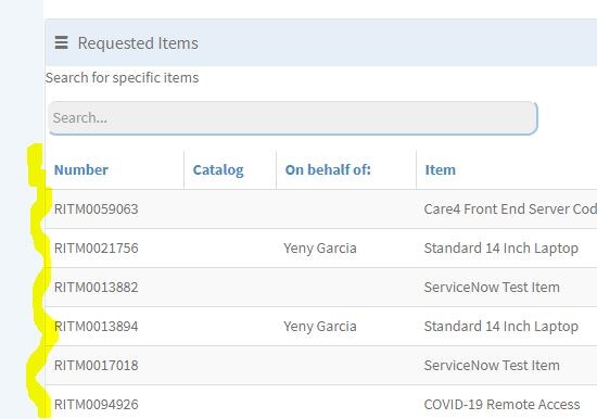

Hi all,
I've been asked to provide a checkbox functionality in the portal to approve/update multiple records at a time similar to the list view in the platform. I'm wondering if this can be done using a data table widget so the user can select all the items they want to update and then just click a button to execute. Has anyone done this before? If so, would you be able to provide some assistance in the html/server part of the widget? If it's not possible in a data table, do you have some suggestions for a custom widget that could provide this same functionality?
Data table where this could possibly be added to:

Thank you Jason! Sorry for getting back to you so late! I did add the checkboxes in the table. I decided to create a new widget instead. This is how it's looking. I still have to adjust some column widths to prevent the titles from wrapping. I also need to figure out how to uncheck the check all box when the user clicks it and then removes a check box from the list.

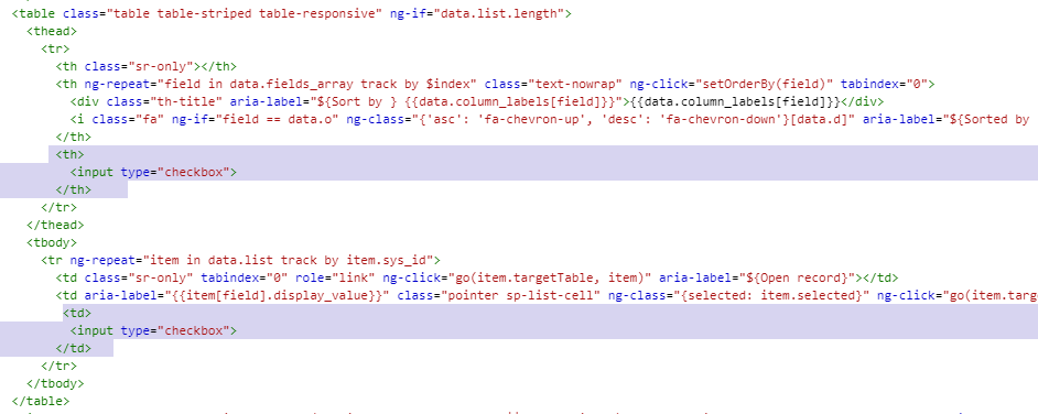

Hi Yen,
I believe you would need to clone the Data Table Widget to achieve this. For the HTML, you could do something like the below to add a checkbox on each row and in the header:
and then a button (or drop down if you'd prefer) in the footer:
The result looks something like this (note: I have added the check-boxes on the right hand side as it was a little less fiddly and avoided re-positioning the headings and footer buttons, although this can be achieved!):
