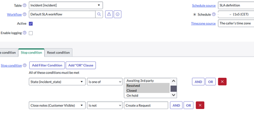

1st SLA:

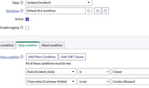

2nd SLA:
one of the task_sla record which in In-progress but incident state is closed.
Could you please check and let me know if having any issues in SLA?
Sattar
@sattar3 Your SLA stop conditions are defined on the incident_state field, can you check on your incident record if the incident_state and state fields reflect the same value or they are different. To me it appears that the stop conditions for the SLA are not matching hence it continues to run. You can also check the Enable logging checkbox on the SLA record to check the detailed logs related to SLA.
