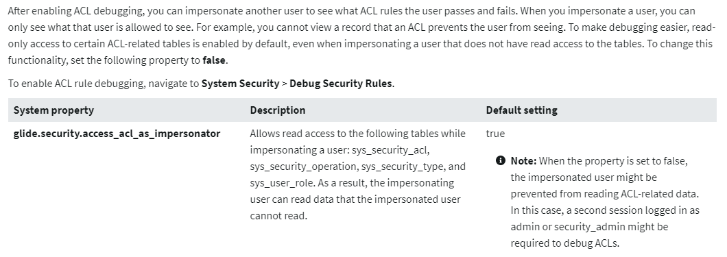

Were you impersonating? If so, for the sake of debugging, read-only access is still given while impersonating. You can turn this off by following the documentation instructions:

02-20-2020 11:30 AM
Issue was with the Admin Overrides. Unchecking worked.
