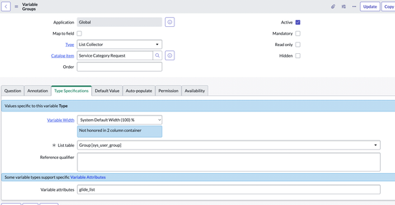

manjusha_
@Marion de Groo1
Under type specification of variable >variable attribute>add value glide_list
Refer below screenshot for reference-

Marion de Groo1
Can you provide a screenshot of what this should look like in the service catalog? Because I think this would turn the whole thing into a glide list and I am looking for a list collector with up/down buttons on the right, to be able to order the list on the right bucket
@Marion de Groo1
Just do it in your catalog item for the required variable, you can see how it looks.
