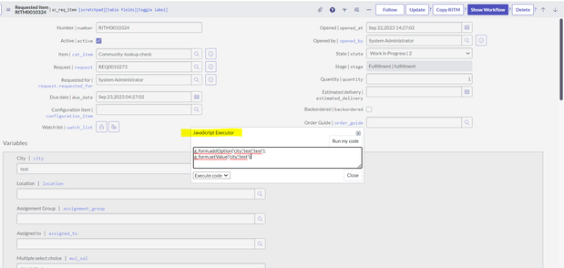

There is one way...!! check if it works for you...!!
Open the form -
press below keys on keyboard , don't remove your fingers from button unless you press 'J'
ctrl + shift + alt + j
the below executer will open --
Write below code & click on "Run my code"  [upper right corner]
//use your variable backend name
//add one dummy option
g_form.addOption('type of licence','test','test');
g_form.setValue('type of licence','test');
This will set the value to type of licence variable.
Now close the executor and save the form.
Let me know if this worked..!!

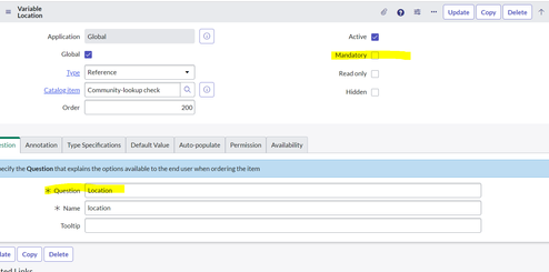

Hi @Codi
1.Check if "Reverse if false" on UI policy making any effect.
2.Can you check if Mandatory check on variable form itself.
3.Also check if there is any scripting on UI policy.

Hi @Vishal Birajdar upon checking everything is ok on the catalog item because the mandatory check box is already thick. The weird thing is the issue is only happening on the particular ticket and to the other tickets is working as expected. The challege right now is we cannot put a value to the mandatory field. Is there any way for us to put a value to the mandatory field?
