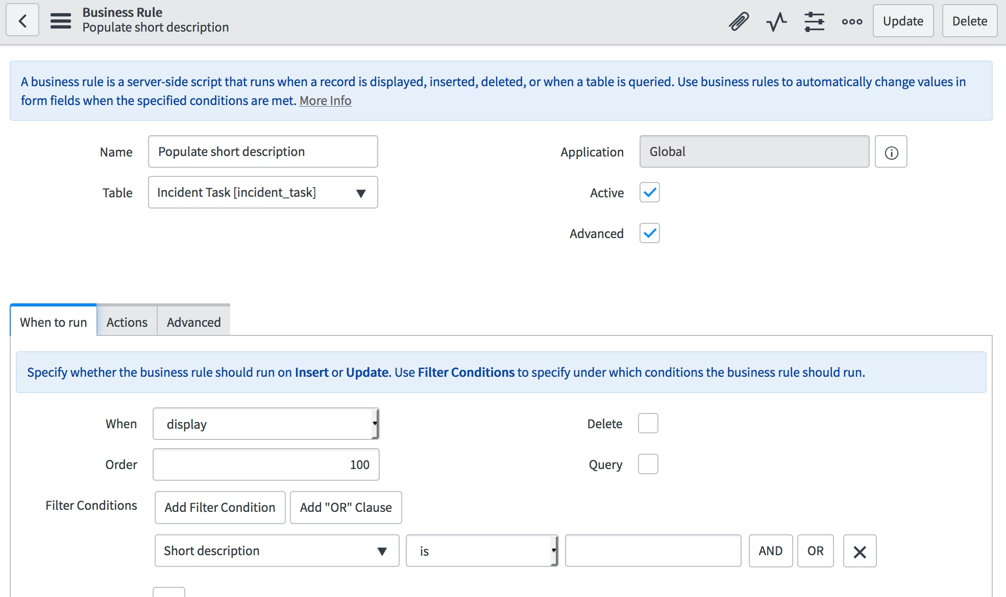

I recommend doing this WITHOUT any code using a display business rule. See the images below on how I did this with the incident task table to pull the short description from the parent incident.
No code solutions are easier to build and maintain. When given a choice between a coded solution and non-code, take the non-code every time. 🙂
The trick is to use the Advanced checkbox.
Set When to Display
Condition: Short description | is | empty
Set your fields values to: Short description | same as | Incident.short description
Set When to Display

Thanks Chuck,
That worked like a charm,
Richelle
