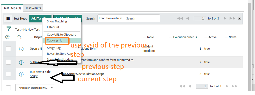

‎06-27-2019 10:47 PM
you do you need script? you can use
1.open an existing record step
2.set field values step
it is possible to fill the task values using the above steps.
OR use the below steps
var gr = new GlideRecord("sc_task");
gr.addQuery('request_item',steps(PREVIOUS_STEP_SYS_ID).record_id);
gr.query();
if(gr.next())
gr.description ="10.123.45.67";
gr.work_notes = 'test';
outputs.sys_id = gr.update();
replace PREVIOUS_STEP_SYS_ID with the sysid of your previous ATF step
-Satheesh
