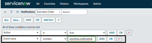

06-18-2026 11:04 PM
Hello Tanushree,
Yes, I have checked all this.
I went to notifications and filter like, Event name is workflow.notification, but I dont see any records.
and also there is no BR or scheduled job triggering this event.
(I seached in all applications and code search)
WHen I checked in the events, It is showing like this
So, can you tell me how to debug now?
