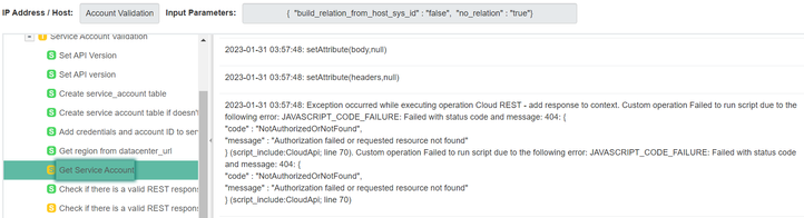

while trying to setup the Discovery schedule -> Cloud discovery -> Validate, I get the below error
I was able to connect out of the box through Oracle CLI with the same credentials as setup in ServiceNow.  The same does not work through the cloud discovery.
I tried to sync with MID multiple times but of no luck.
Log snippet from MID server is provided below:
Please advise, how do I fix this issue.

Clicking on the Test Account I am getting a validation error which is what i have been saying so far. Screenshot of which is provided below. Details of the validation error  was provided in the initial thread.
