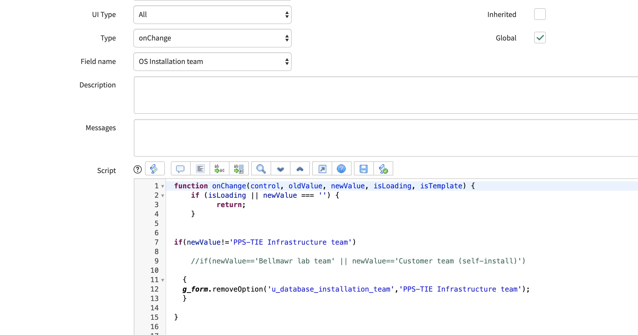

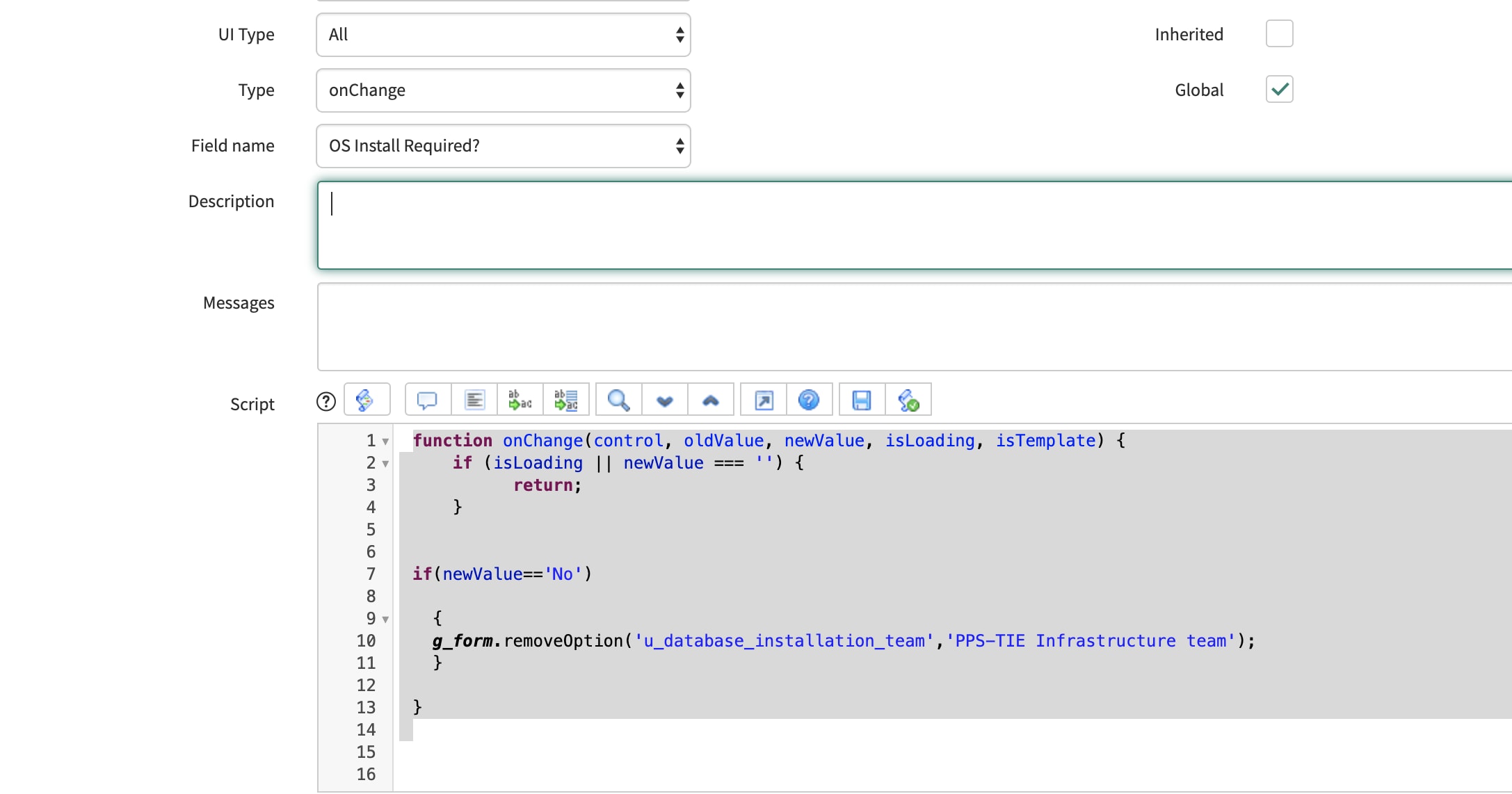

Hi all,
I have a simple requirement , but not working as expected .
As per two fields , i have to remove a option
Field 1 : IF u_os_install_required is NO
Field 2 : OR IF u_os_installation_team is "BELLMAWR" or "CUSTOMER" .
FIELD 3 : u_database_installation_team - REMOVE THE OPTION "PPS"
This is working as expected .
BUT before submitting, if they change their mind and want to make changes . It is not making the changes .
Also tried form getValue(), this method is not working too .

02-05-2020 01:23 PM
I think you should control how the user returns to the 'zero' state in the form and the behaviour of the choice options, it should be something like this:
if(newValue === 'no') {
g_form.removeOption('u_database_installation_team','PPS-TIE Infrastucture team');
}else{
g_form.addOption('u_database_installation_team','PPS-TIE Infrastucture team');
If t was helpful, please give some positive feedback.
☆ Community Rising Star 22, 23 & 24 ☆
02-05-2020 06:17 PM
Guys ,
I have already tried the If else part , it doesn't work . And it doesn't work without a reload
