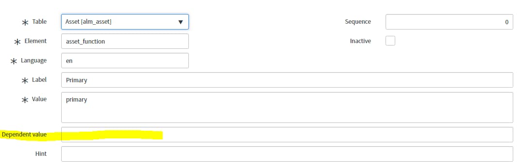

02-11-2022 02:08 PM
Hey Staxed,
Did you get a chance to try the "Dependent Field" option while creating the choice field? As it gives the user a direct option to declare the dependency of choice list values on another field's value.
Putting up an example from alm_asset table for your reference:
When you do this here in the dictionary entry itself, you can define the dependent value while creating the choice as follows:
