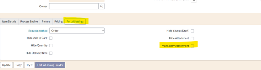

Ensure the script I've provided you with is in an onsubmit catalog client script with the UI Type of 'desktop'. Delete your other script(s) you've created as they're not needed. Then use the checkbox function I mentioned previously to control the mandatory attachment requirement in the portal.
TL;DR - The script is making attachments mandatory in the glideapp backend view, the OOB functionality of the "Mandatory attachments" checkbox on the catalog item is controlling the portal/mobile view.

I just wanted to confirm that the client script is working fine on the Service Portal, right? If it is, then it's normal for the catalog item view (or Try It view) to not reflect all the customizations we made with client scripts or UI policies. That view has some limitations.
Since it’s working well on the Service Portal and ESC, you don’t need to worry too much about that view.

I understand the client's request, but I want to point out that the Try It view is primarily intended for admins or catalog owners to quickly test functionalities and see changes. Generally, users will interact with the Service Portal or the ESC, as those are the primary interfaces.
In my opinion, you can inform the clients about the limitations of that view. It’s not designed for actual submissions or comprehensive testing—those processes should occur in the portals.
Given that we can achieve the same requirement by simply checking a box to make attachments mandatory, it might not be necessary to implement a custom script for that view.
