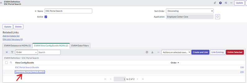

1- Go to your Portal and access it Search Result Configuration:
2- Open the EVAM Vew Config Bundle where "Taxonomy - Catalog Order Guide Genius Results" should be located.

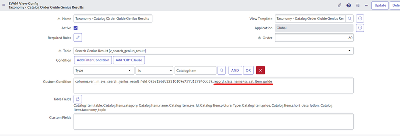

3- Open "Taxonomy - Catalog Order Guide Genius Results"
4- At this point we shoud be seeing this:
I do not know why, but the value of "record_class_name" column in this case will allways be "sc_cat_item", so this OOB configuration will never work. I suppose ServiceNow has mapped that column with Cat Item Table column instead of Class column. I could not reach that mapping configuration.

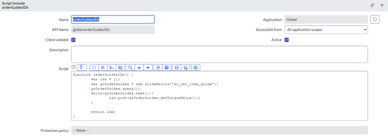

5- Create a new Script Include (client callable), this is my example:
Script:
function orderGuidesIDs() {
	var ids = [];
	var grOrderGuides = new GlideRecord("sc_cat_item_guide");
	grOrderGuides.query();
	while(grOrderGuides.next()){
		ids.push(grOrderGuides.getUniqueValue());
	return ids;
I made it available for All aplication scopes, but it may not be necessary.
Inserted and adjusted the role permissions.

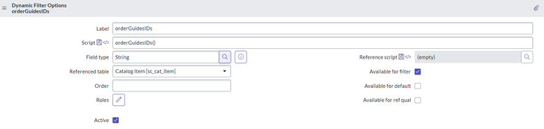

6- Create a new Dynamic Filter, calling the previous script:

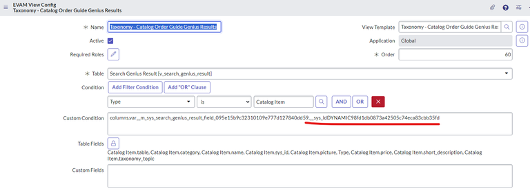

7- Go back to "Taxonomy - Catalog Order Guide Genius Results" and change the Custom Condition:
In my case:
columns.var__m_sys_search_genius_result_field_095e15b9c32310109e777d127840dd59.__sys_idDYNAMIC98fd1db0873a42505c74eca83cbb35fd
98fd1db0873a42505c74eca83cbb35fd is the ID of my dynamic filter, copy yours and palce it afer "DYNAMIC"
- __sys_id is the internal name of the column sys_id.
