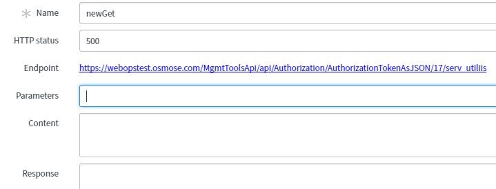

But testing it using a REST Message object always fails with 500.
I see in my server log (on webopstest) that the endpoint is being hit from servicenow and returns 200.
it's a simple 'get' with no authentication. should just return a string wrapped in a JSON object.
I'm on Istanbul, build 6 I believe. Oh, also I'm a n00b, so don't assume that I haven't missed something simple.

08-17-2017 05:46 AM
Hi Charlie,
Can you check the authentication details shared you have correctly applied in ServiceNow.
Can you share the screenshot as well. How you have configured the rest message and how you are consuming it via script.

Hi Charlie,
Can you set the Authentication type as None and test it once.
Http error 500 means internal server error nothing to do with ServiceNow.
Mark Correct if this solves your issue and also hit Like and Helpful if you find my response worthy based on the impact.
08-17-2017 06:26 AM
I changed the Authentication from Inherit to No Authentication, but it gives 500.
Added Headers for Content-Type and Accept, but it made no difference.
I appreciate you all looking into this with me, thank you!
