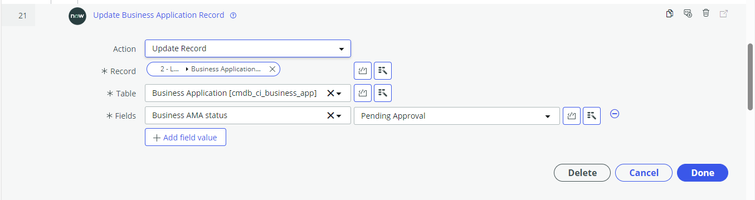

I've created a flow where I'm tying to update the value of a field. What I'm currently trying to do is:
However, what I've noticed is that if I raise a request with the flow, the following occurs:
Does anyone what I can do to override business rules from running so that my flow can run without any issues?

Not sure if you found a solution to your question, however, one option is to create an action containing a script step that you can call from a Flow to update the record without running the business rule.
This example is based on a use case i had:
  1. Create Flow Action
  2. Create 3 inputs:
  3. Add a Lookup Record step. Pass in the Table input variable, and script the condition to get the record based on RecordSysId input variable:
  4. Add a Script step
	var fieldValue = JSON.parse(JSON.parse('"' + inputs.fieldvalue + '"'));
	for (var key in fieldValue) {
		inputs.record.setValue([key], fieldValue[key]);
	inputs.record.setWorkflow(false);
	inputs.record.update();​
  • Save/Publish Action
You can then use this action in a Flow and pass the Table name, sysId of the record to update, and the field name/values to update:
