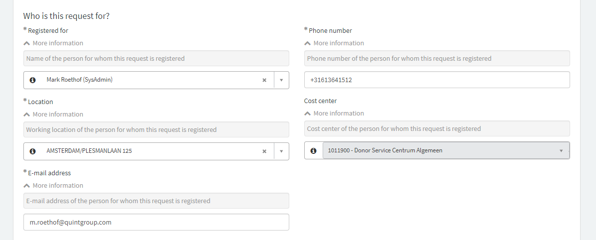

Curious about this one, I tried to reproduce this. Though, while overriding the variable (on the variable set) thru a catalog client script on the catalog item, it looks like the default value + the onchange filling of other variables is overwritten. Is this what you are also after? Or did I misunderstood your question?
Without overwrite:
With overwrite:
Basic onLoad Catalog Client Script on the Catalog Item:

I already have code that looks very similar to that, and that part works fine. The issue is that there are Catalog Client Scripts running one the Variable Set that are populating the related fields, and when I try to select myself as the user, my code immediately clears out the requested_for field, but not all the related fields (it populates them with information about me).
So, the flow appears to be something like this:
1. I choose myself
2. It populates all the related fields about myself
3. It removes me from the requested_for field, but not any of the related fields
I even tried added explicit commands to clear the values out of the other fields (under the one that clears it out of the requested_for field), but that didn't even work. Try as I might, I cannot get it to clear out the requested_for fields when I try to select myself under the requested_for field.
