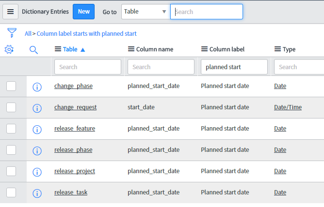

The challenge you face is Planned Start and Planned End don't exist on task.   They are attributes of tables that extend task like change_request, release, etc.   You can always search the Dictionary Entry table and look for fields that have the label you are looking for to see what tables they are on.   Here is what's available in my out of the box instance for Planned Start:
Work Start and Work End (aka Actual Start and Actual End) are attributes of task.   So you could use a business rule to populate those fields for consistency.

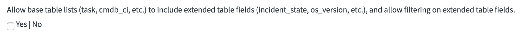

Chuck Tomasi
Another option might be to go to System Properties> UI Properties and check this box. It allows you to pick the fields on extended tables on a list of tasks.
