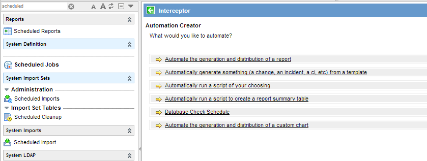

Would a scheduled job not do it simply?
The below appears when you choose new for a scheduled job:-
