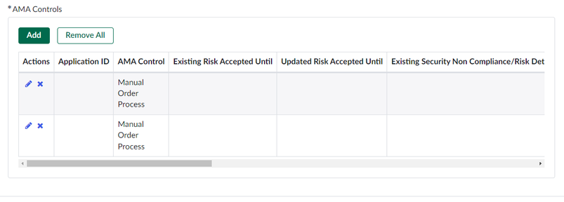

I've got a multi row variable set that allows a user to select different AMA controls. However, what I've just noticed is that a user is able to select the same control twice for a Business Application.
If the above example, the user should only select the 'Manual Order Process' AMA control only once. I was just wondering what I can do to stop the same AMA control being selected. A user should only select each AMA control once, not multiple times.
